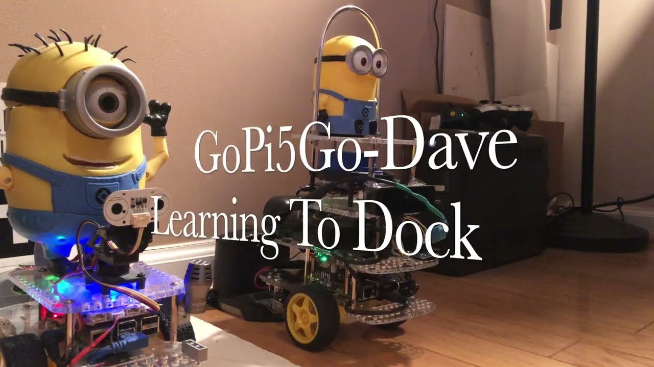

Driven by my C++ keyboard controlled drive program, GoPi5Go-Dave attempted his first docking:
Discovered I cannot have a Python GoPiGo3 battery monitor program active while the C++ program is driving Dave - Unexpected behaviors will occur.
Oh no. It was looking so good until the very ending.
I think that’s one of the reason the turtlebots were designed wider and flatter.
/K
Dave’s CG is purposely close to the wheels to improve turn_degrees() accuracy. I’m going to have to re-evaluate the central battery pack location.
(The TurtleBot 4 had a honkin’ counterweight in the whole back of the accessory drawer.) Indeed if I was a 3D printing wizard, I would print up a wider GoPiGo3 base plate and use the raw encoders instead of the GoPiGo3 API which only returns whole degree precision. WIder would give better heading measurement accuracy as well as turn accuracy.
New battery location (did not affect turn accuracy that was previously fine tuned with wheelBaseRotateTest.py):

Of course it all started with trying an algorithm to detect when to stop (backing onto his dock) by watching the average battery voltage and the change in average battery voltage.
Update: the plan changed when I got Python working…:
