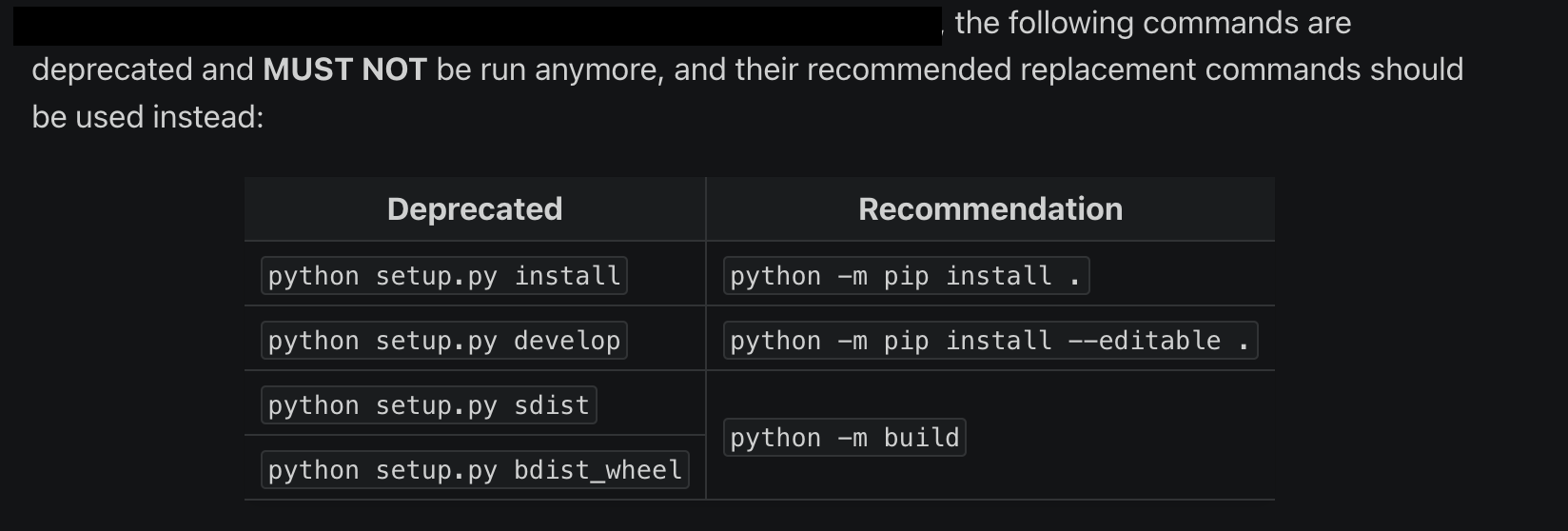

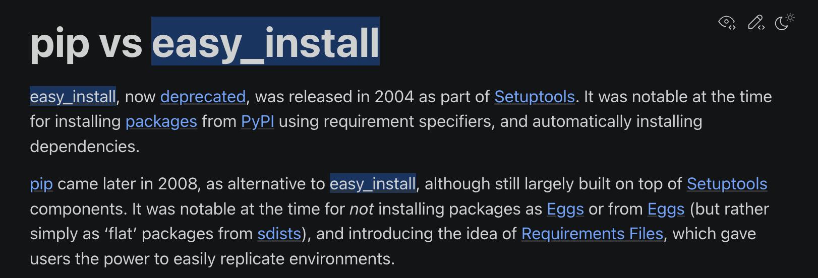

Over the last seven years, I have been reasonably successful at hacking the installation of the GoPiGo3 software stack (hardware interface and examples) for both Raspberry Pi OS versions and Ubuntu versions. Along the way, I have seen more and more warnings about deprecated software in the Python API build process - such as:
/usr/lib/python3/dist-packages/setuptools/_distutils/cmd.py:66: SetuptoolsDeprecationWarning: setup.py install is deprecated.
Please avoid running ``setup.py`` directly.
Instead, use pypa/build, pypa/installer or other
standards-based tools.
See https://blog.ganssle.io/articles/2021/10/setup-py-deprecated.html for details.
self.initialize_options()
/usr/lib/python3/dist-packages/setuptools/_distutils/cmd.py:66: EasyInstallDeprecationWarning: easy_install command is deprecated.
Please avoid running ``setup.py`` and ``easy_install``.
See https://github.com/pypa/setuptools/issues/917 for details.
running bdist_egg
running egg_info
creating DI_Sensors.egg-info

Should anyone be willing to accept the mission to modernize the Python GoPiGo3 software installation, this will be a useful guide:
https://packaging.python.org/en/latest/guides/modernize-setup-py-project/
From the guide:
As mentioned, I have managed to hack a sufficient for me install but the use of a 21 year old installation package makes the future look increasingly dark for the GoPiGo3.
