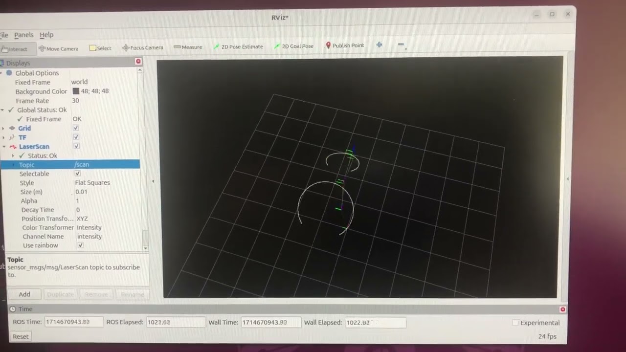

rViz2 runs at 15-18 frames per second in a 6" by 4" window, and at 5-7 frames per second in a 16x9 inch window. Was not recommended on a Pi4, but on this Pi5 it “works in a pinch” Uses 35% of processor and 1.7GB memory
rViz2 runs at 31fps on my Mac VM with 8 cores 8GB assigned - as long as I pick x11 window manager.
