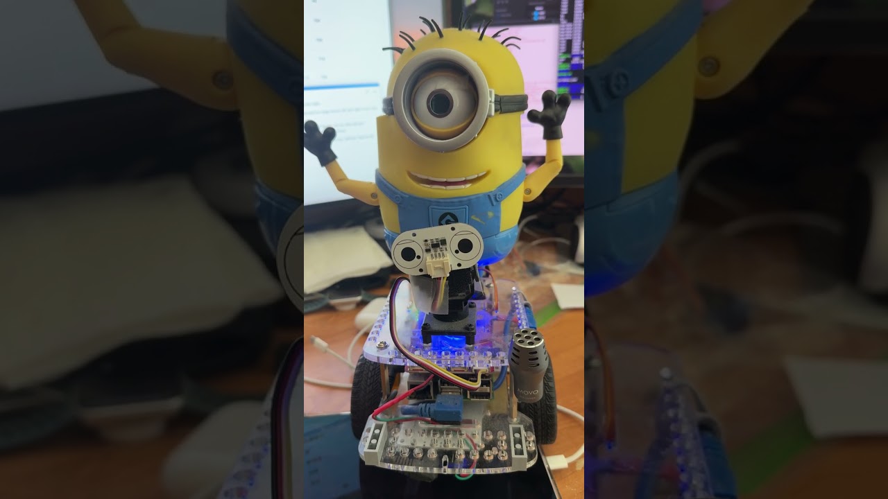

I started to wonder if Carl had suddenly passed the singularity last night.
Out of the blue he announced “Nodding No” and indeed panned his range sensor left and right in his “unh-uh” nodding no behavior.
My wife commented she didn’t know he could do that, and I explained “oh yes, he can also nod yes.”
But when I told Carl: “Hey Carl, Nod Yes”, he stubbornly refused to my embarrassment.
Digging in further, I discovered the tilt servo had frozen after eight years of non-use. Until his “Two for $6” servos arrive, Carl can only “Nod No”
Both Charlie and Charlene had “hung” servos when I fired them up recently. I bought a “Bag 'O Servos” (ten) online only to discover that the central hub - and the plastic “horns” - are all the wrong size for the robot’s pan-and-tilt.
It’s a good thing I got the bulk pack - I discovered that the other servos - that appeared to be working - had slipping gears and they didn’t fit the central hub and horns either.
Oh well. . . .
Out comes the razor knife and a box of band-aids.
Before trimming the horns, check the spline count and shaft diameter against the original servo—some “standard” micro servos use a different tooth count even when the case looks similar. If the new horns are close but not quite, a thin adapter or a 3D-printed horn may save the knife work. Slipping gears under load can also mean the servo is marginal for the pan-and-tilt, not just worn.
