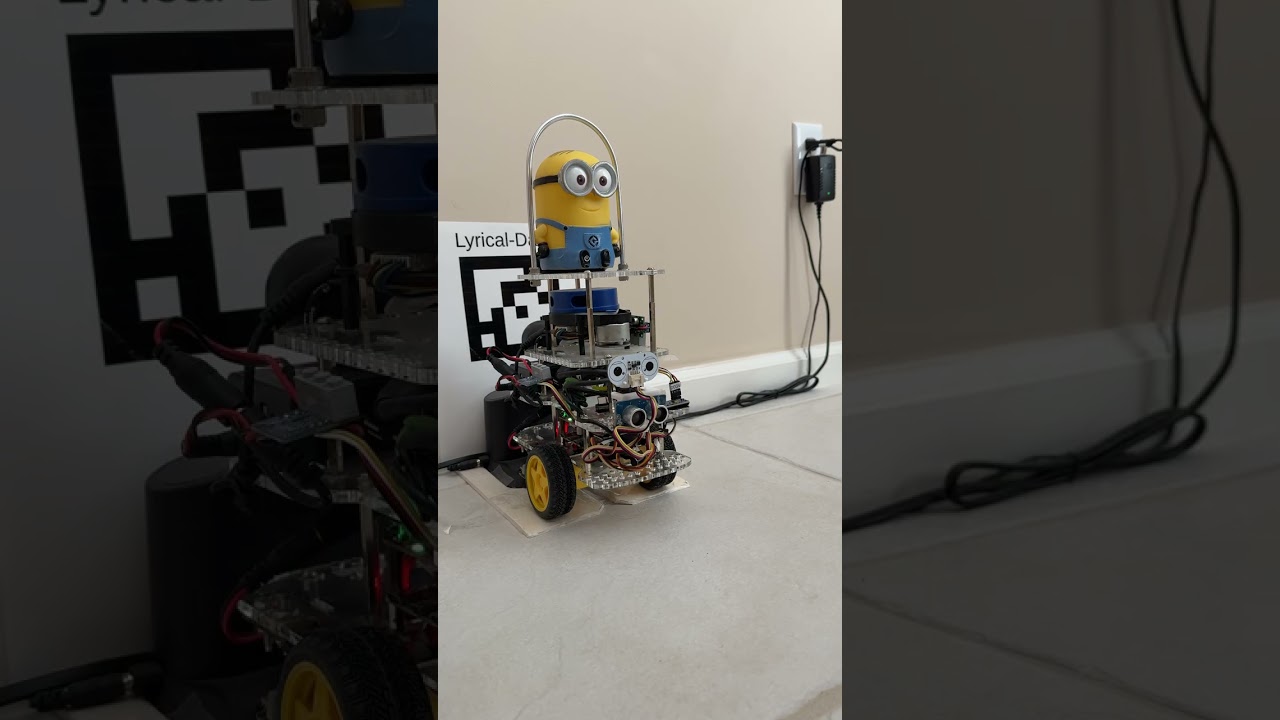

First GoPiGo3 Robot runs “validated safe” URML Program
It was bound to happen, but didn’t expect it like this:
And then …

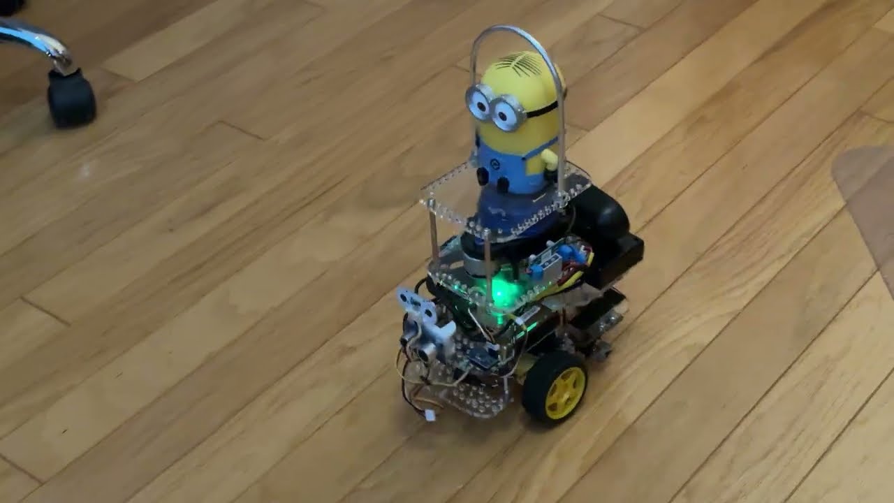

Dave is lovin’ this URML stuff - lots of stuff to do during his “playtime”.
Still some things to work out. Dave is testing “orbits”:
Not sure why I am pursuing getting the URML project to have a GoPiGo3 runtime - perhaps because I miss being needed as a tester and developer.
Many people told me I would miss working after I retired (9 years ago), and I told them “forget it - I’m going to play with my robots!”
Here I am playing with my robots pretending to be a tester and developer, but w/o the pressure and egos.
