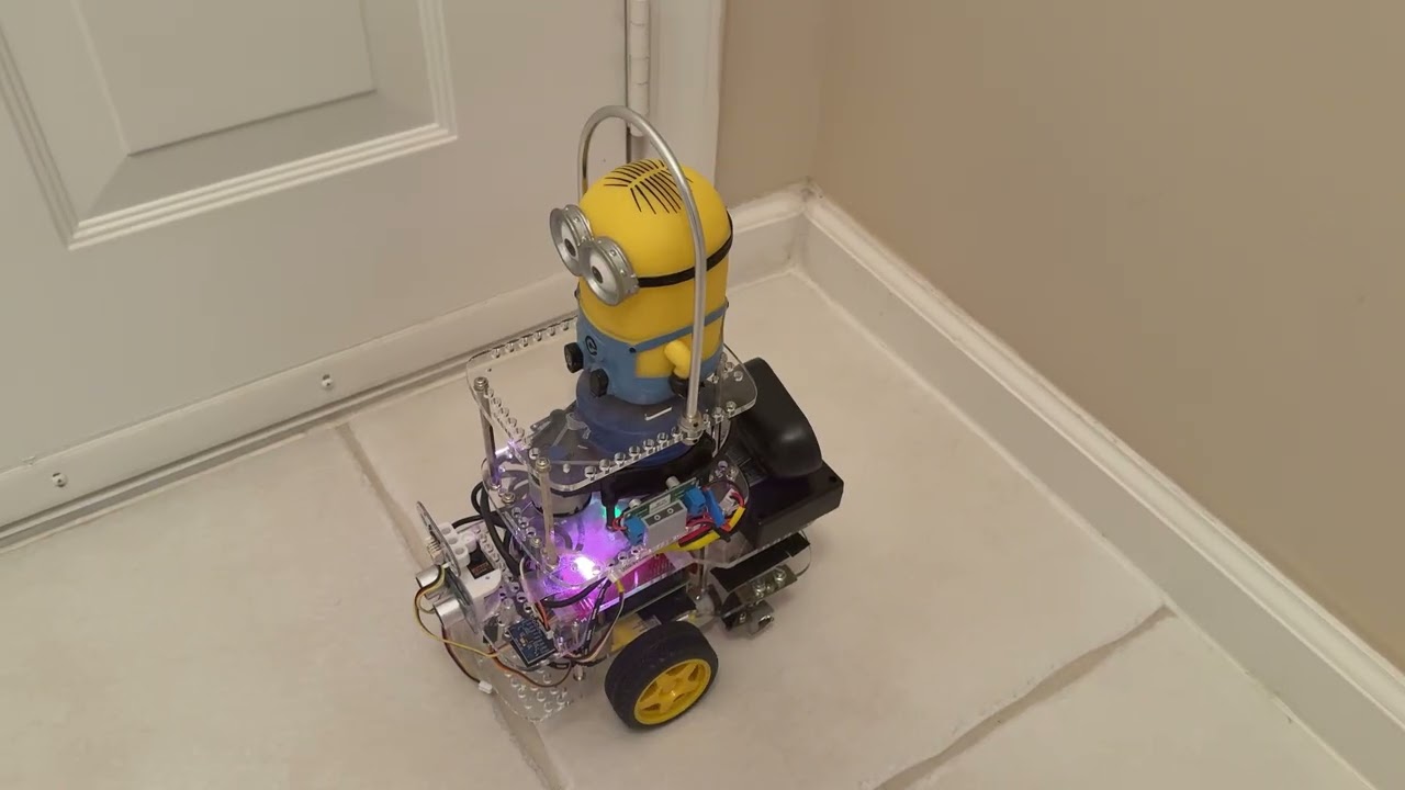

I added speech and Dave immediately began annoying me with his “worm thoughts”.
As @cleoqc advised, there are some issues with the project code implementations, even on the Raspberry Pi4.
The original was written when only the Raspberry Pi B+, single core processor was available, and the CEO/Pres of DexterIndustries attempted an “experimentalOptimization”, which indeed has a faster cycle time, but Dave mainly sits announcing the amount of food in his virtual stomach more than pleasant to hear or watch.

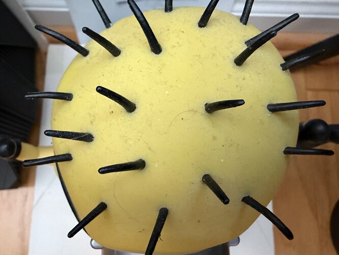

When Dave’s “worm brain” first finds the food, it seems to pound Dave’s nose into the food (wall) risking a motor stall, so I have to keep “pulling the worm out of his brain”.
If he keeps this up Dave’s head is going to have worms coming out like Carl’s has been for the last eight years:

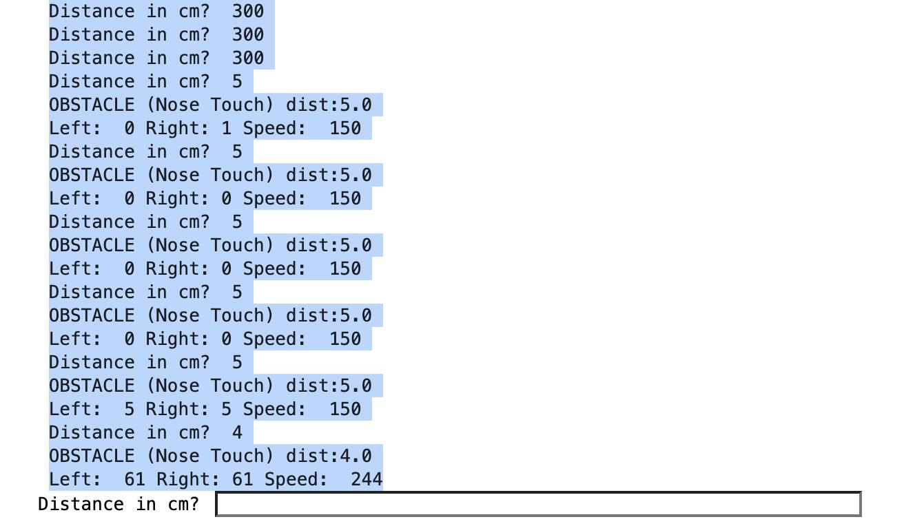

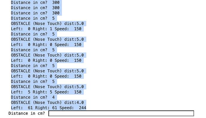

Same behavior: When it touches some food (dist < 100 or 200cm), it stops for a few “bites or smells”, then slowly starts toward the food, and then races forward jamming its nose against the food. Might work for a worm, but very disturbing robot behavior!
Actually I haven’t the slightest idea what the outputs are saying, or what the worm is “thinking”.
And when the worm is given a 0 distance, it reads one more time, and if again 0, the worm explodes!
Little terrorists they are.
OBSTACLE (Nose Touch) dist:15.0
Left Eye on (40, 10, 10) Right Eye On (40, 10, 10)
Left:  0 Right: 0 Speed:  150
Left Eye on (5, 5, 5) Right Eye On (5, 5, 5)
