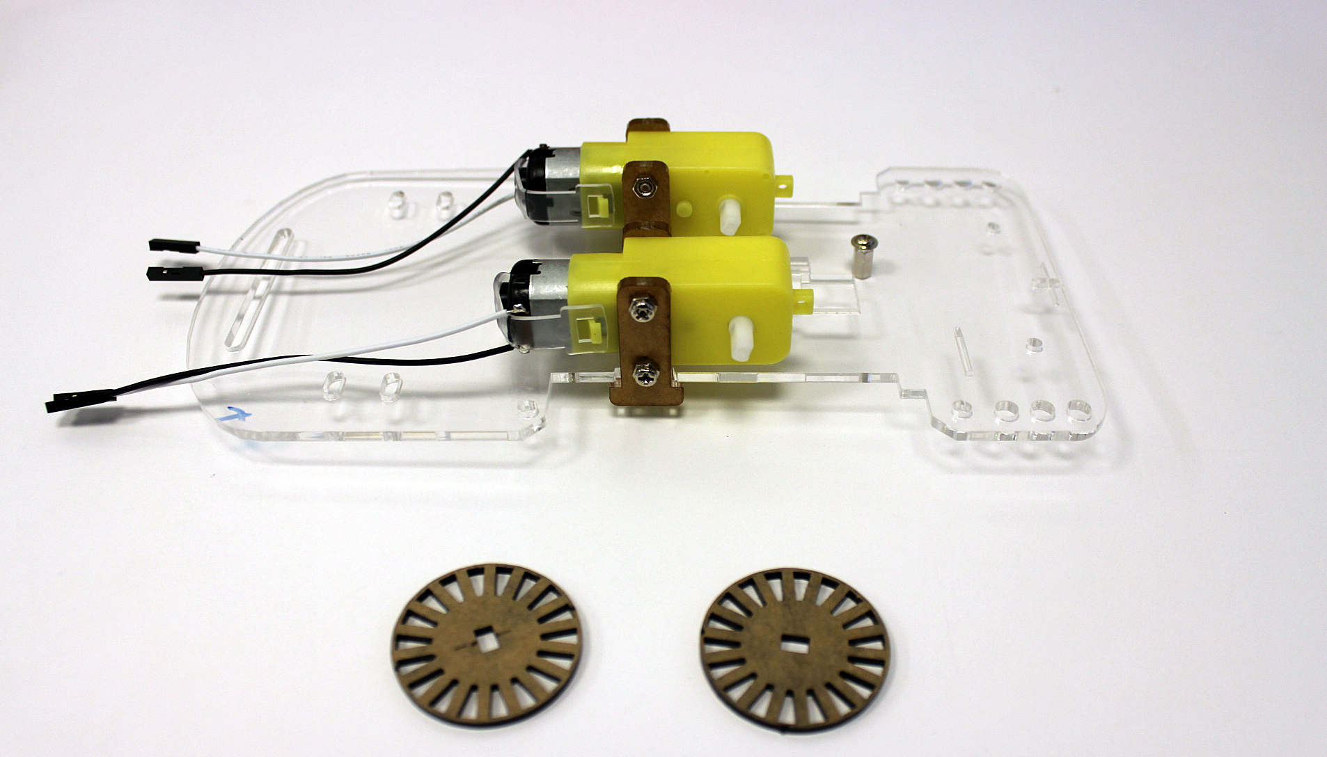

CleoQc, do you have the encoders attached to your motors?
Yes they are attached. (That’s the black circles, right?)
Yeah, is the the circular thing with slots cut out http://www.dexterindustries.com/wp-content/uploads/2014/10/60-1.jpg . Just make sure that the tape in there on top of them.
