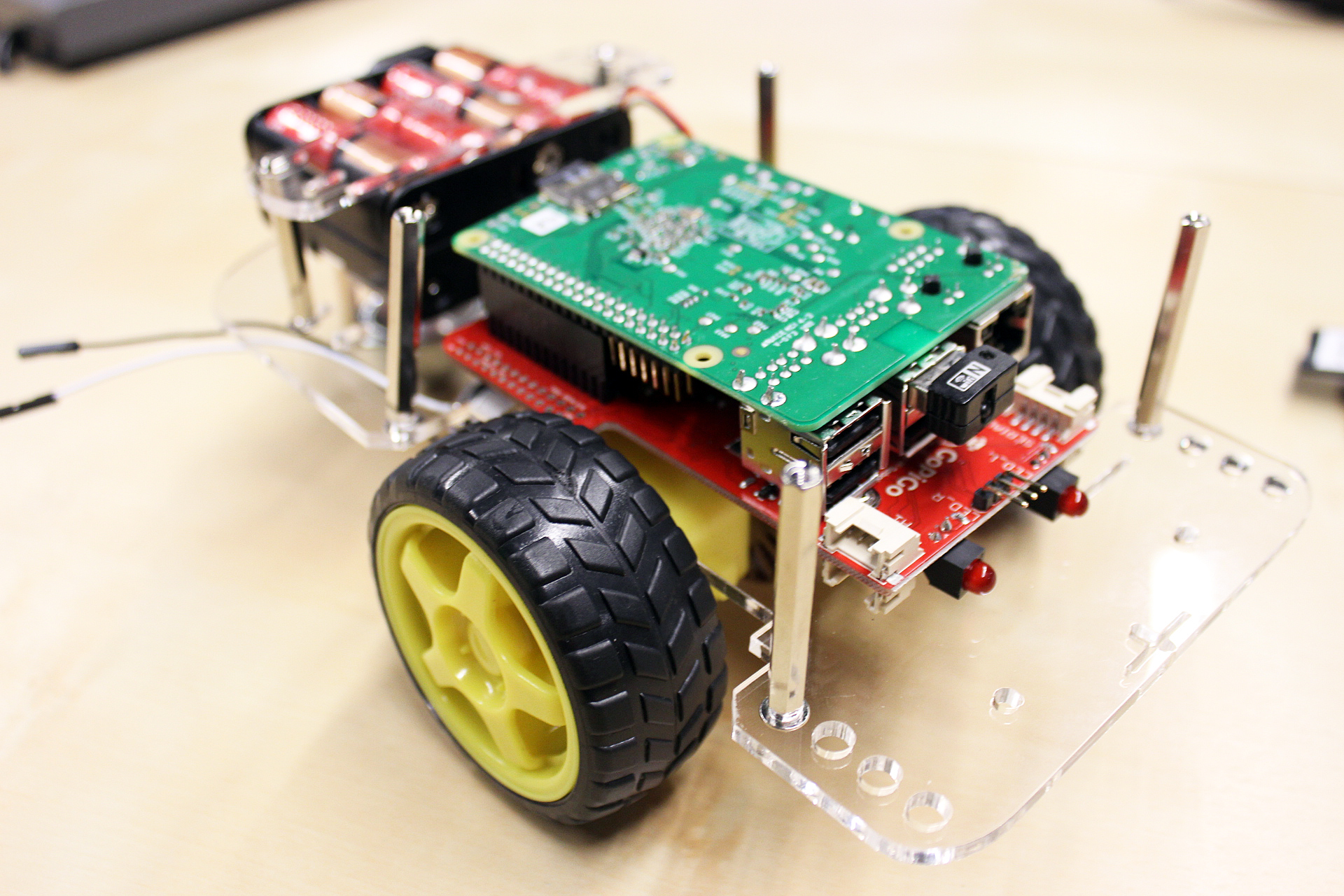

Does the Green power LED on the GoPiGo turn on when you power the board and can you just double check if the GoPiGo is mounted correctly on the Raspberry Pi GPIO pins. It would be great if you could post a few pictures of your setup.
If this does not work for you, then it appears that we shipped you a defective GoPiGo. Can you contact us through our contact page for a replacement, under “General Questions and Feedback”http://www.dexterindustries.com/site/?page_id=65 and also mention a link to this discussion. I’ll also let the team know about this and we’ll send you a replacement ASAP.

Thanks for looking into this. Yes, the green LED is on. It’s difficult to see the LED in the attached photos because I had to use flash in order to get a decent pic.
I think this is correct, it seems to match the pictures on DI’s website (in particular http://www.dexterindustries.com/wp-content/uploads/2014/10/931-3.jpg )
