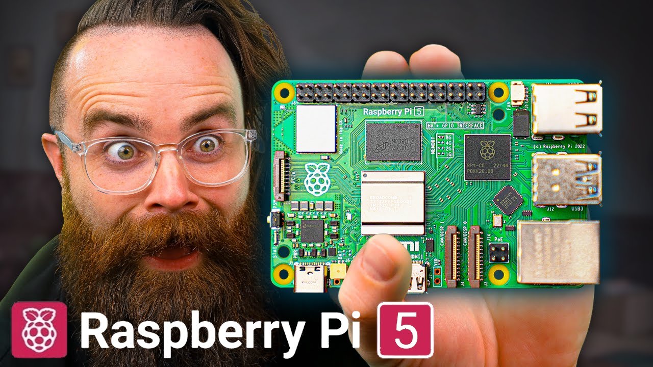

Raspberry Pi 5 is coming out soon
Here’s what Hackspace has to say about it:
Cool beanies!
I want one!
Cool beanies!
I want one!
