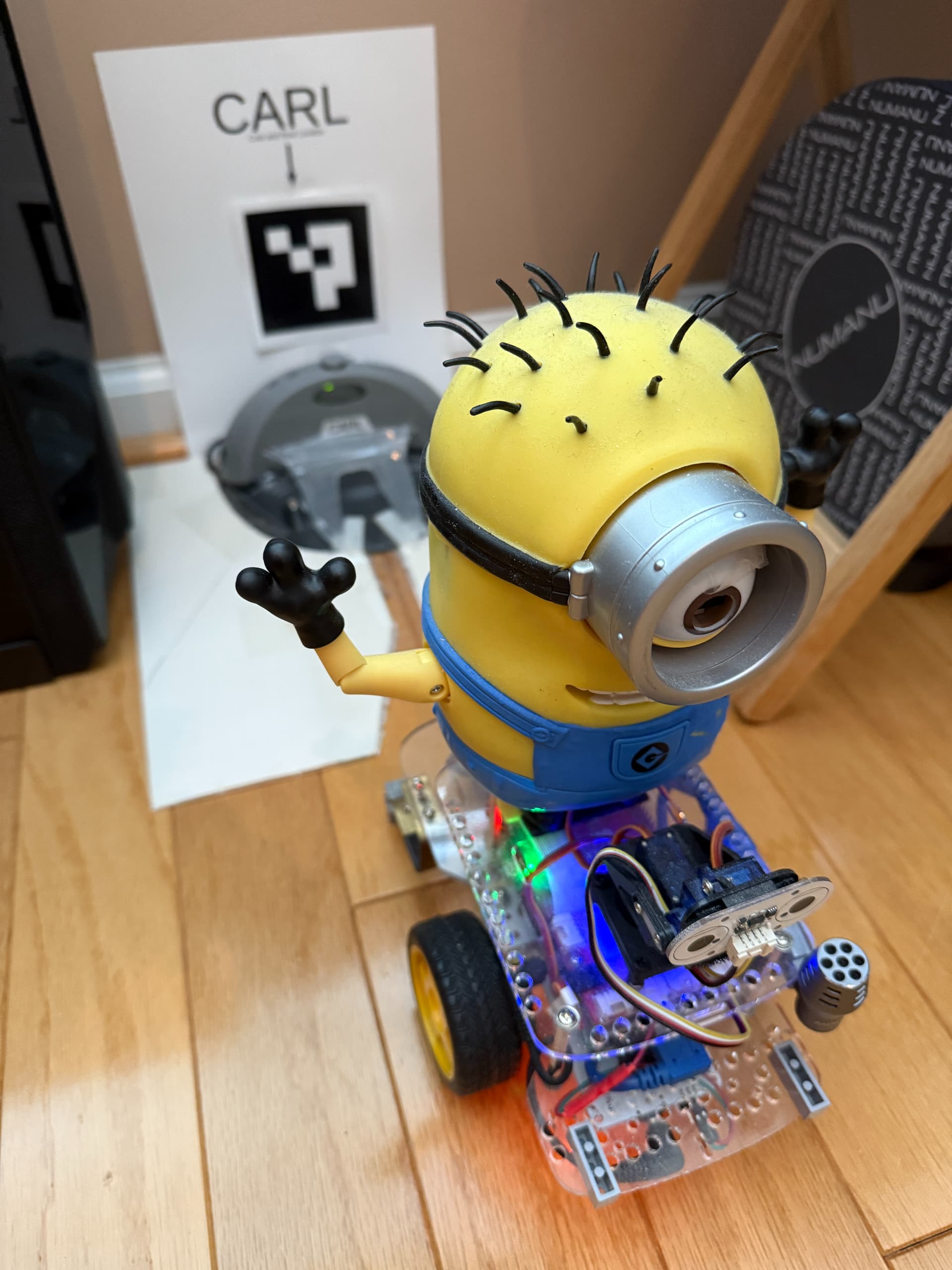

Carl sporting his blue “I’m Listening LED” again, (but don’t talk too fast)
