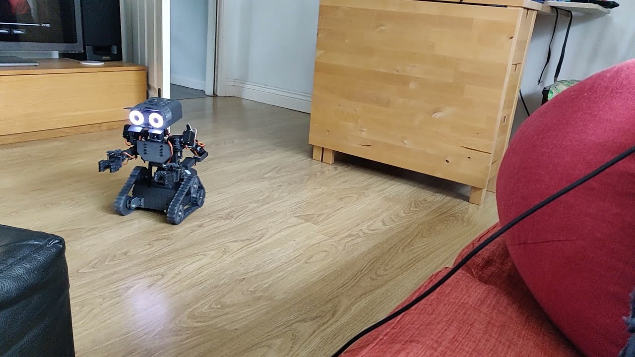

AND teleop_twist_keyboard actually drove Dave around a little.
Wow - that’s fantastic. Dave is alive!!
I don’t like the teleop-keyboard, so I’m glad I got the joy node working. Depending on how much driving you anticipate doing might be worth trying it. I already had a controller from an older project (I’m not a gamer), but you can get a generic Xbox controller for < $20 on Amazon. You could probably ask around as well - I’ll bet there are a lot of abandoned wired controllers as gamers have shifted to wireless. Your friends (or their kids) may have one laying around. Or check the GoodWill.
/K
