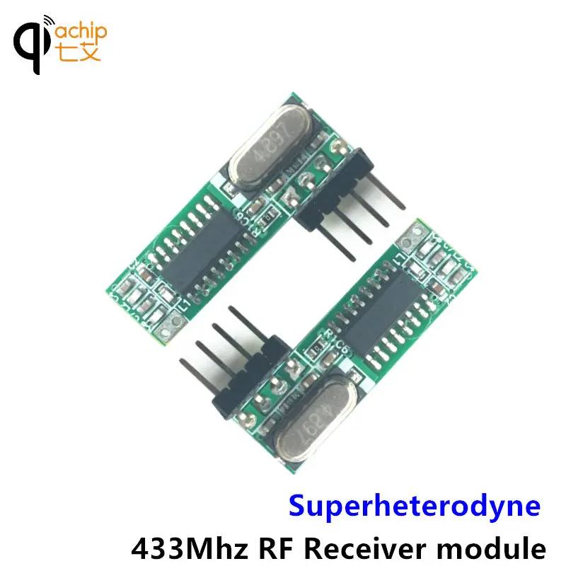

I know that the library work with a lot of the simple RF receivers and transmitters.
Also with some more powerful RF receiver/transmitter like this Superheterodyne.
