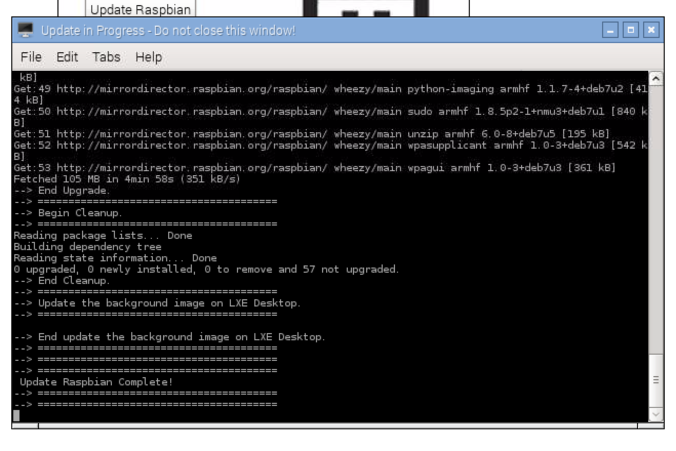

Pretty sure the Raspbian upgrade completed fully.
Here’s what the screen looked like:
http://ibin.co/2YtwgjcQCGjg
Yes, I rebooted.

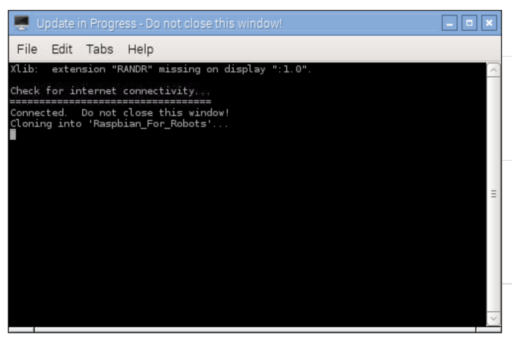

Unfortunately, after the Raspbian update I am no longer able to launch the “Di Software Update” program, so I can’t get to the place where I start the firmware upgrade.
When I click on “DI Software Update” now, it does not give me the 3 options that it gave me before.
It just jumps directly into the Raspbian install again.
Here’s how it starts:
http://ibin.co/2Yu1NPT7aT4y

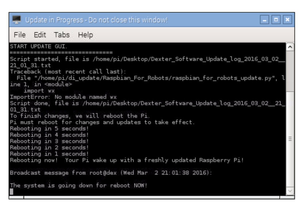

Here’s how it ends: (Notice the error message)
http://ibin.co/2Yu28YSDDqr9
Here’s the log file.
 ?   >cat Dexter_Software_Update_log_2016_03_02__21_01_31.txt
Script started on Wed 02 Mar 2016 09:01:31 PM UTC
Traceback (most recent call last):
  File "/home/pi/di_update/Raspbian_For_Robots/raspbian_for_robots_update.py", line 1, in <module>
    import wx
ImportError: No module named wx
Script done on Wed 02 Mar 2016 09:01:32 PM UTC
Looks like a missing wx module is causing some problems.

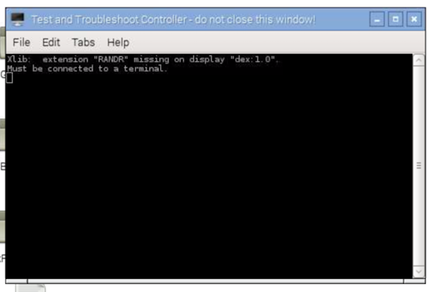

When I click on the “Test and Troubleshoot” shortcut
A terminal displays very briefly but then dies before doing anything.
Here’s what I see before it dies.
http://ibin.co/2YuBpZg52Lhg
