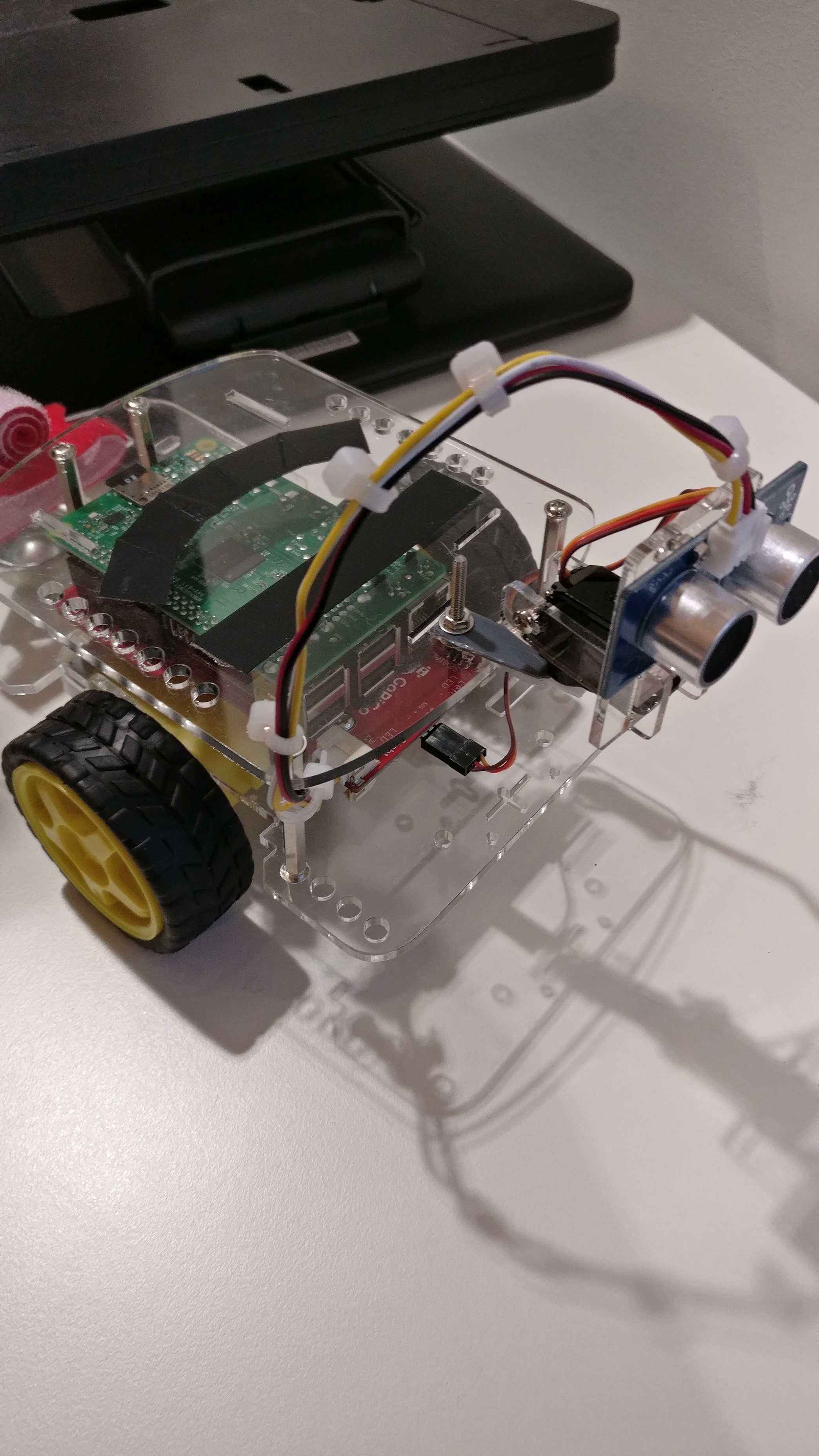

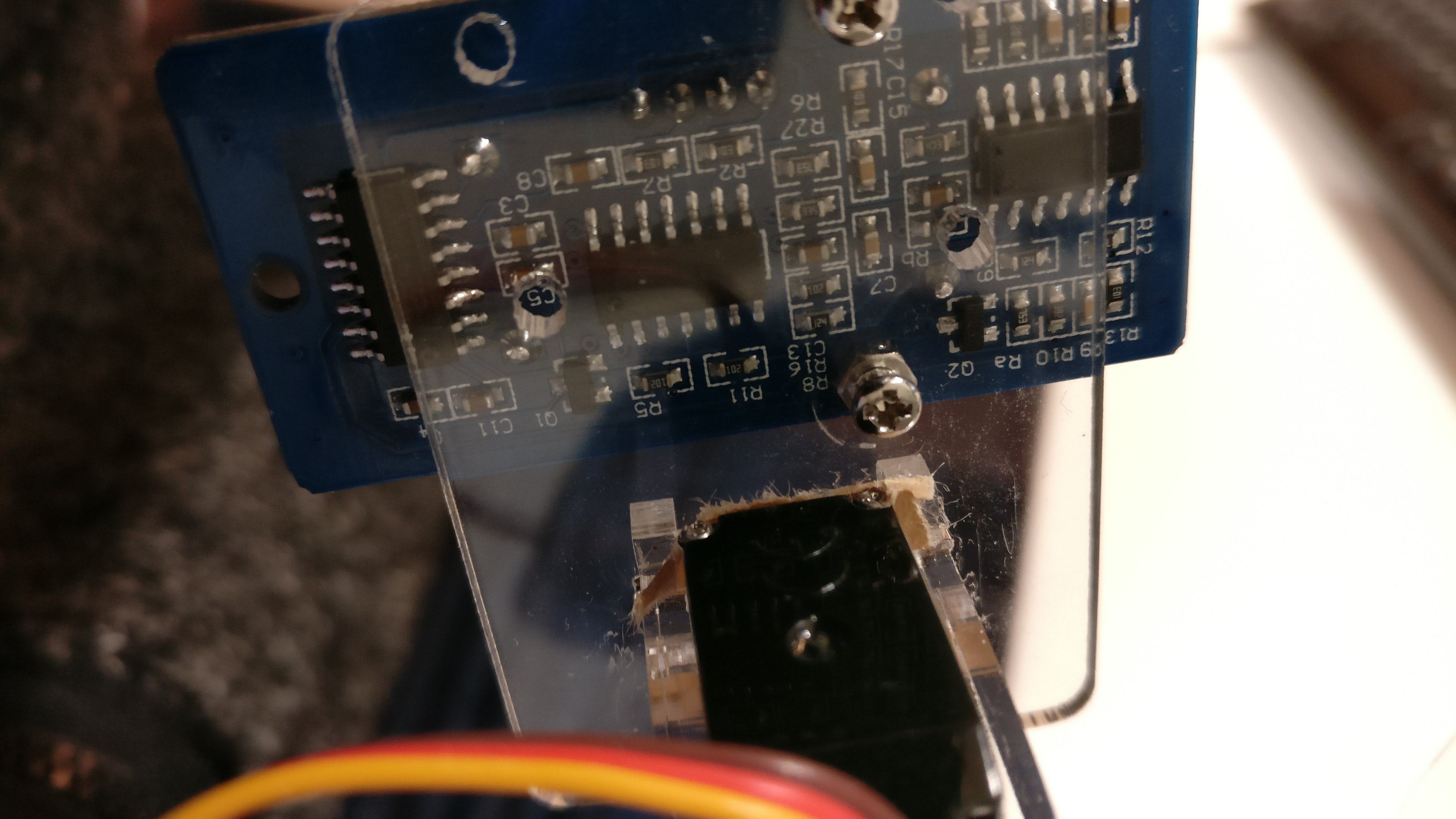

Now I noticed that the IC on the ultrasonic sensor (behind the sensor marked with T) gets really hot!
The whole board is hot and the sensor in front of the IC is also not touchable hot.
In code, when I get the distance get a variation of 684 and 685.
the code (see below) does work, after I let the IC cool down.
Is there any solution to this heat issue? How can we avoid this? Is there any heatsink to cool the IC?

Hi @anton.kirschhock,
Can you tell us to which port are you connecting the ultrasonic sensor to and also also share some pictures of the GoPiGo board and the sensor.

Hello @Shoban
I use the adviced analog A1 port.

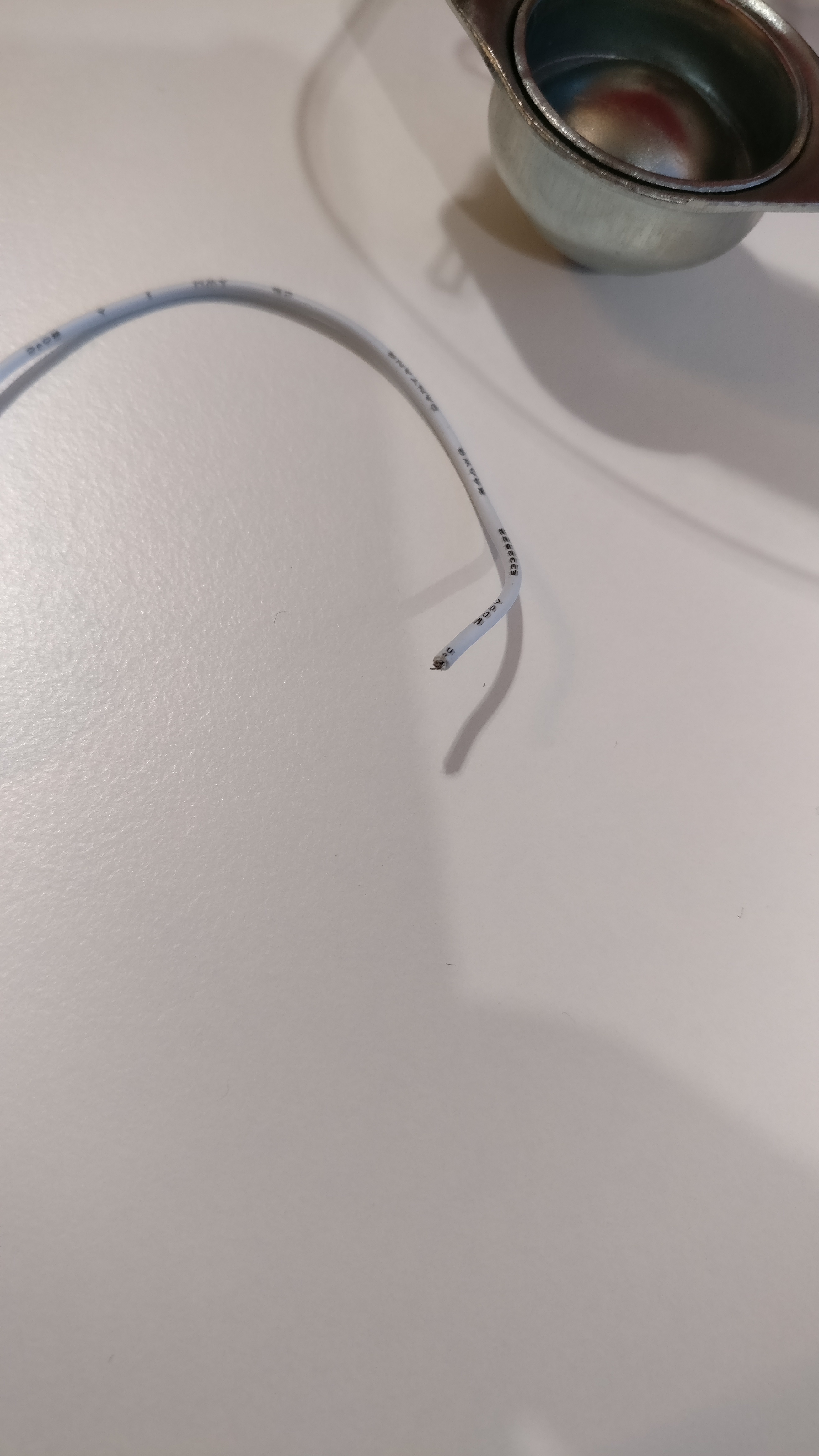

Concerning the logs, one of the motor wires are snapped off. The broken wire looks like metal fatigue to me (see fotos).
Have you any tips for that aswel?

@anton.kirschhock: coming back to the motor wires snapping off, how did it happen. Did it accidentally snap or did it just wear down and came out after prolonged usage.
Guess wear and tear of reassembly (for a guide I had to make for our course). But got that fixed with another motor, which I had. It is the ultrasonic sensor which I am more worried about, as these motors are commonly used in robotic kits :slight_smile:
